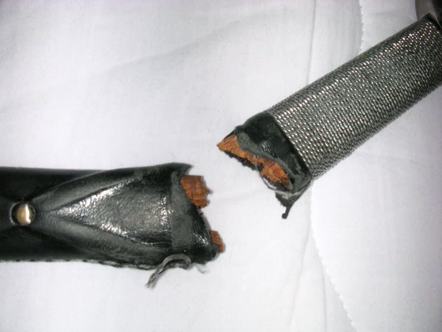

This is what happened to my MRL when I did a quarter speed schiller in the air. I don't buy swords from them anymore.
Where's the tang of the blade???!! <img src="/forum/images/icons/shocked.gif" alt="" />

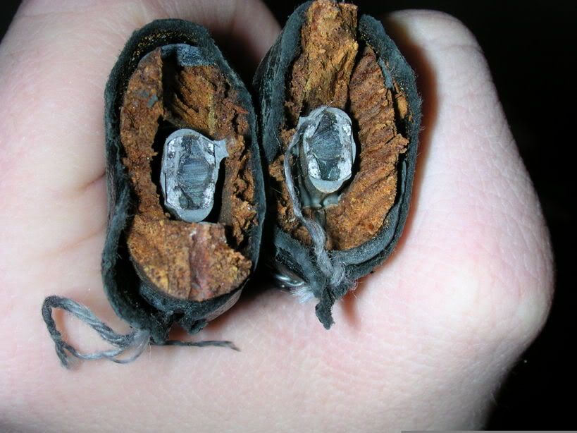

You mean this little thing? The light gray is JB Weld.

I don't mean to speak for Derek but isn't that the Gothic sword from last decade's production? Isn't it also one of the tangs with a welded extension? It seems most do it poorly but Lutel has had success. I don't push my DT5157 too hard because of this.
I do agree that Windlass still seems to suffer from fit and finish issues, as well as the "springy is better" syndrome, this from many reports over the past six years. There have been suprisingly few failures reported. I have suggested the Shrewsbury to some on a budget, with suitable caveats, and the response to the sword has been favorable overall. Many of these folk are not going to be doing a Tsafa with them.
The overcooked grain growth can be a real issue. There really is no way for a consumer to see it, until after the fact. I had a Hanwei blade literally rip in half under severe blows and the blade had perfomed wuite well up to that point. That grain made the tang pictured here look almost normal. Holding the steel too long at heat apparently makes for grain growth.
