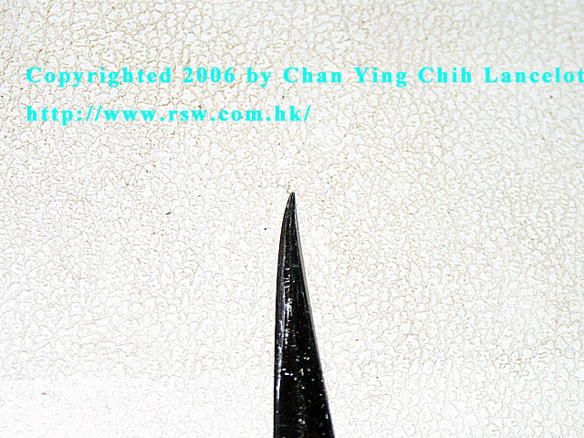

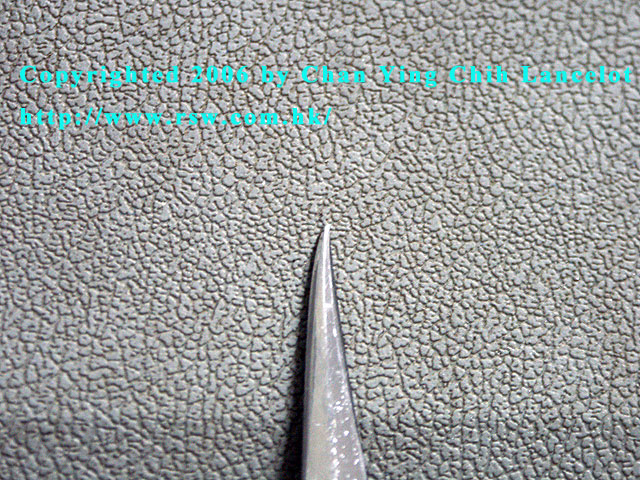

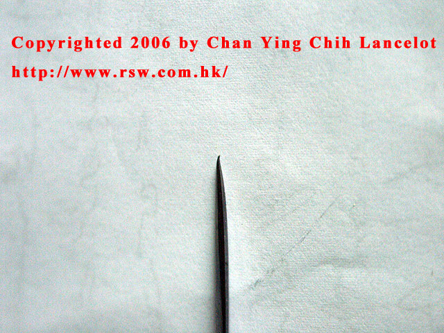

Well, your sword ain't alone. I cut flesh with the brescia spadona tip and it bent in both planes of the blade (edge and flat). I fixed it myself though by just pulling it back to the opposite direction with hands on a clamp.
