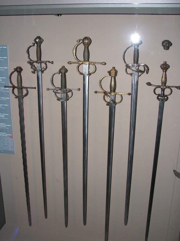

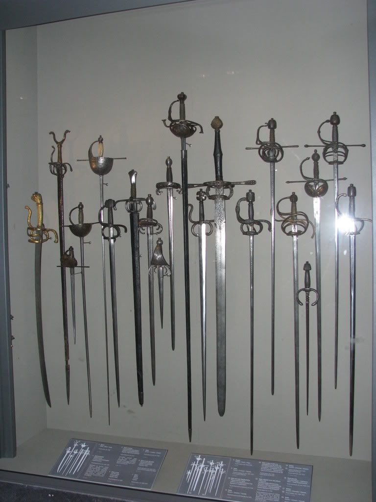

Here are some photos of cut & thrust swords from Les Invalides, Paris.
1
2
3
4
5
Some of these swords are more thrusting oriented and some are more cutting oriented. Some have knuckle guards, some have side rings, some have finger rings. I can pretty much see any hilt configuration on any blade. Especially in that last photo you can see heavier broad blades and more tapered ones, some are even true rapiers. So there is a broad spectrum of one-handed swords during the 16th century. One of the swords in the first photo has an Oakeshott type XIX which looks very much like the blades Albion puts in their Condottiere, Kern, Doge, and Machiavelli (http://www.albion-swords.com/swords/albion/swords-albion-mark-nextgen.htm#Hand-and-a-half). I wouldn't really consider Albion's type XIX to be "cut & thrust" swords, though some of them would certainly fit in the 16th century. They seem to be cutting swords, hold-overs from the previous medieval period. The Oakeshott XII and XIII remain common blade types throughout the Renaissance period as well. In the 16th century, medieval style cutting blades, in-between cut & thrusts, and rapiers all seem to be used.
I wish I had measurements for the swords in these photos. I would guess that most of the one-handers are within a 30-35 inch blade range. There might me one or two that stretch that. Rapiers of course could be longer. Since 16th century comprise a full range from rapier to earlier style cutting swords, I imagine that a 37 1/2 inch blade (the NSA waster) would still be ordinary though not typical. You wouldn't be surprised if you saw one, but it wouldn't be what most people carry. The balance points of the Albion XIXs are 5", 5 1/2", 5 1/8", and 7". The NSA is approximately 6 inches, but the blade is 3 1/2 inches longer. So you get a longer blade with about the same balance point. Another point to consider is George Silver's recommendations for blade length. A 37 1/2 inch blade is just right for me based upon his way to find your proper length. While 37 1/2 strikes me as long for a one-hander, he says that this is your proper length for a two-handed sword as well. 37 1/2 certainly falls within the normal length for longswords. I wouldn't be surprised if Silver's recommendation played an important role in the design of this waster. But is this the norm for the swords of his day? Is this the length the Italians or Germans favored? Was Silver's opinion widely accepted or was he trying to change the status quo like he was with English use of the rapier?
I suppose this gets into how we define a cut & thrust. Not that we need to set firm boundaries between cutting swords and cut & thrusts. The NSA certainly falls within the range of 16th century swords. And it is a great waster. I highly recommend it. And I could be wrong in how I understand 16th century cut & thrust swords.

I can't say I have handled original swords either, however I own a Milanese rapier from Arms&Armor that I think would be considered a cut&thrust sword by ARMA members. The blade length is about the same as what you have measured on your waster, so it's not exceptional I think to see that.
Reproducing an accurate balance on a wooden sword while keeping it solid enough to withstand the rigors of training is a challenging task. Compromises have to be made... Quantifying the dynamic balance of weapons is also something that needs more than CoG. If you can measure pivot points as I described here, it should be possible to say more. In fact I'd be very curious to compare this wooden sword to the other trainers I have numbers about.
About the Albion swords you mentioned, it should be noted that the Kern has been described as having a different balance than most swords. It has the same blade as the Condottiere and Machiavelli, but the ring pommel is much lighter, giving a forward balance to the whole sword (more about the Kern here). I don't think its CoG of 7in should be considered typical of cut&thrust swords in general...
