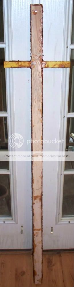

Postby shane wink » Fri Apr 01, 2011 7:27 am
Got up earlier and pulled the sword blank from the oven. I had cured the blank for 4 hours @ 180 degrees using my bow oven.
Looks nasty huh :)
Image[/img]

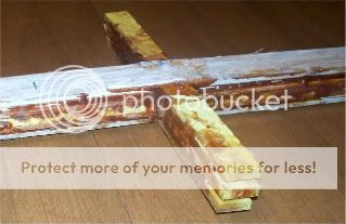

Postby shane wink » Fri Apr 01, 2011 4:05 pm
I sanded the epoxy skin coat smooth and added a leather wrap on the handle. I weighted the waster and it came in a just over 2 .25 lbs. I drilled a hole in the handle to add weight too later but for now I will use it without the weight to begin with.
All that is left are a few coats of polyurethane.
you can see the laminates here

Postby shane wink » Mon Apr 11, 2011 7:15 am
Nah those are 6" scraps of osage with large knots! I just flat sanded them and glued them up. I have beat the snot out of the pell with it and it shows very little wear., i am happy with it thus far.
I build custom TD hybrid longbows with all bamboo cores and have shyed away from the osage and hickory except in risers so lots of pieces laying around.
