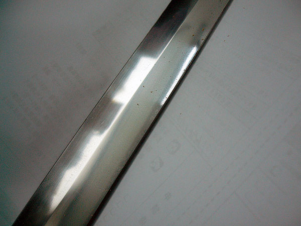

My first sword has finally arrived! It was made by Tinker-
Did a quite crazy test cut today <img src="/forum/images/icons/cool.gif" alt="" />
I will post the review soon, please stay tuned <img src="/forum/images/icons/smile.gif" alt="" />

Seems that Lance is busy updating the site and still editing the video, gotta post more before everything's ready!
The sword has these spex:
Length: ~47 inches
Weight: 3.55 lbs
CoG: ~4.5 inches
Handle: ~10 inches
Big ol' buddy, like me <img src="/forum/images/icons/smile.gif" alt="" />
The test cutting target included pig skull- no observable damage after the cutting though. But Lance's... <img src="/forum/images/icons/frown.gif" alt="" />

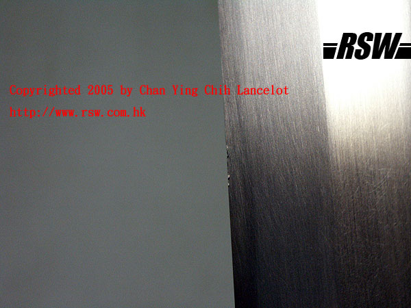

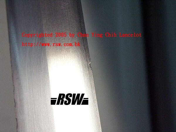

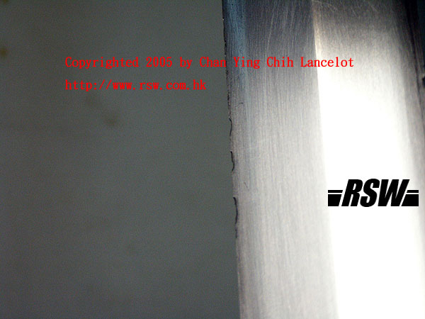

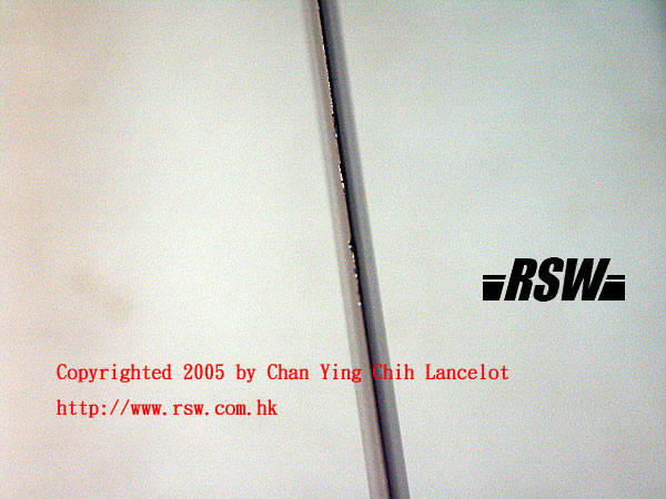

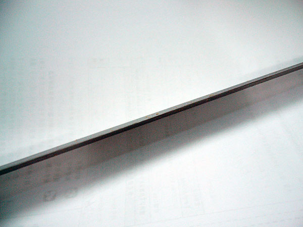

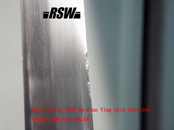

This is the report on the test cutting of the sword. In this experiment, two swords were tested. The first sample is from the Albion Swords LTD, the Brescia Spadona from the Museum Line. The second one is the Tinker-Alfred War-sword No. 2.
The set up of the experiment is a target on a non fixed PVC plastic tube, with leather wrapped. This allows some diversion of force after the cutting. Of course, live targets would not diverge the force after being cut. So this set up can be said to be more challenging than a live target.
The target in this experiment is pork. Aside from the usual pork arm, pig heads were also prepared. Pigs’ constitution is tougher than human.
Result of the Brescia Spadona:
Pig’s head: The cut can cut into the cheekbone. The edge was extensively damaged and became serrated.

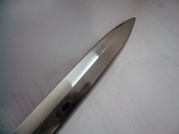

Result of Tinker-Alfred War-Sword No.2:
Pork arm: No matter if it is a diagonal cut or a vertical cut, the strike cut into the arm with tissue connecting the remains. The last strike, aside from completely cutting the pork arm into two, also split the leather wrapped PVC tube clearly.
Pig’s head: Every cut can cut deep into the cheekbone, not observable damage on the edge afterwards. The thrust sliced the tissue upon contact. After cutting, the thread of cord-wrap handle was loosed out.
Conclusion:
The Tinker-Alfred War-Sword No.2 performed better than the Brescia Spadona, in both cutting performance and durability.
The damaged edge of the Albion Brescia Spadona sample
The edge of Tinker-Alfred War-sword No.2 sample:

I would like to add that the Tinker's sword features a concave distal taper, which means the thickness diminished much faster at the base of the sword than the other part of the sword. The distal taper is non-linear.
The hardness of the replacement Brescia Spadona at the damaged spot was between 55HRC to 50HRC, lower than the first one I have that was 55HRC right at the edge. However, the outcome wasn't that different between the two swords. Hardness reading doesn't paint the whole picture. I've to say though, in terms of appearance, the second replacement is a FAR better one! It is even better than the show sword and the review sword on some website with the rivet block totally integrated with the shape of the pommel that one can't tell there's a rivet block at all. Plus Albion took the effort to make every line of the sword clear and as symmetric as hand-made possible (in terms of western sword standard).
As of whether the damage on Brescia spadona is extensive or not, I'm not educated enough to say for there are many experts out there to determine what's the acceptable wear and tear on a historical accurate medieval sword. However, it is now clear what set my standard of expectation in terms of durability 3 years ago when I bought my first tinker's sword.
