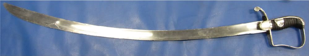

Here’s a Sabre I use that gets regular abuse, I’ll try to get a close up of the blade later for you. Zoom in for a better look, but to describe; most of the ‘saw toothing’ is at the end near the point or at the base near the grip. This is due to me parrying blows and someone else parrying my blows. For this weapon all parry’s happen on the edge of the blade, on the lower half of the weapon. Parrying on the flat with this type of blade will not allow me to strike back with any decent attacks, or just get my blade knocked aside.
Now systems of using the blade are very different, and some swords especially Viking swords are easily held in a position that receiving a cut on the flat may be preferable. I trust one of the other guys here will describe ‘cutting into a cut’ but I I’m unsure how applicable that would be to a bronze era blade. A Bronze era weapon would most likely have been used with a shield, and most attacks would be received on the shield and it would be rare to parry with your sword. But also remember a sword in the hands of a warrior is a tool, not a piece of jewelry to be protected, the nobles who didn’t have to fight can use them that way. Thus if I need to receive an incoming strike on the flat or the edge of the blade I’ll do it, I don't care about damage. I will not risk my own life to protect a piece of metal that I can replace by picking up some poor dead guys sword, or buying a new one after I get back from the battle.
Now can you get pictures of the blades you are referring to, if you show us those we can give you a lot better idea of what may have made the ‘marks’ on your blades.

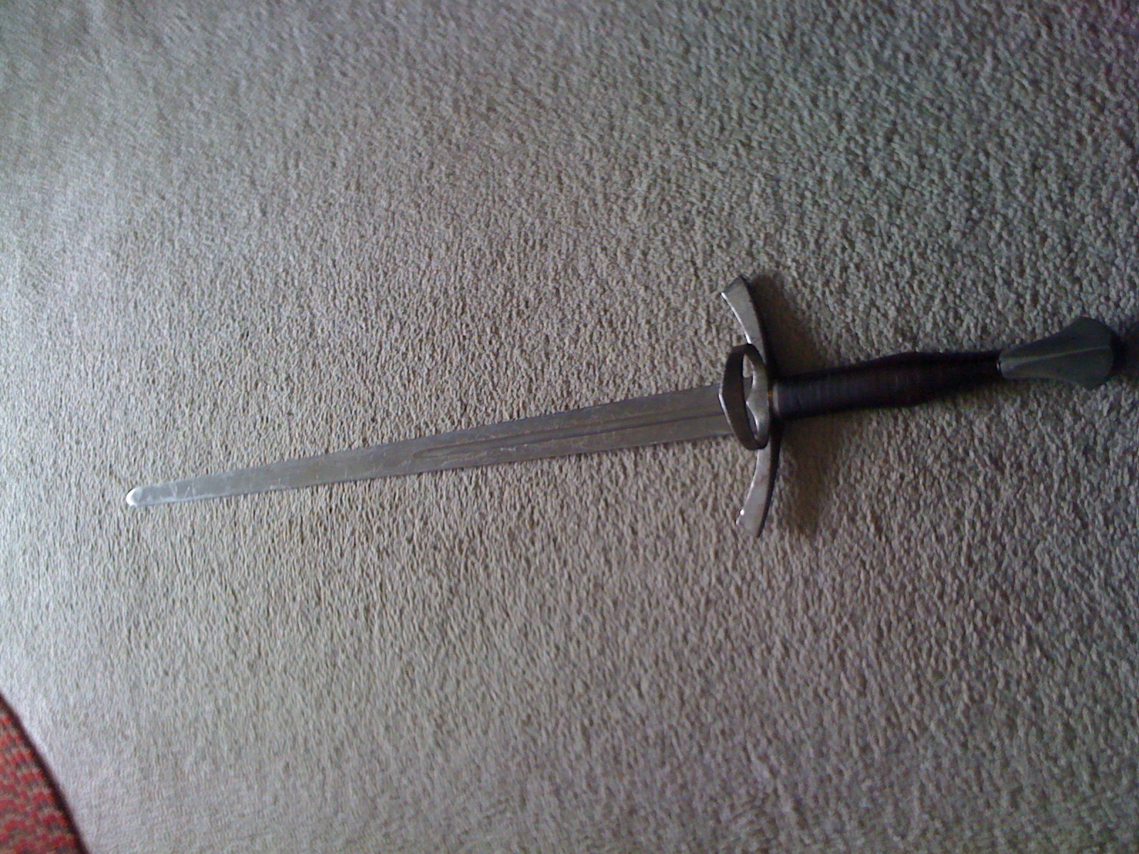

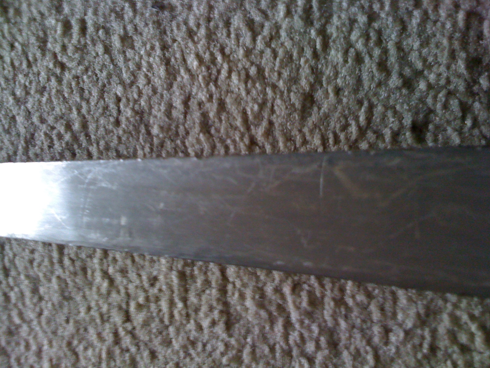

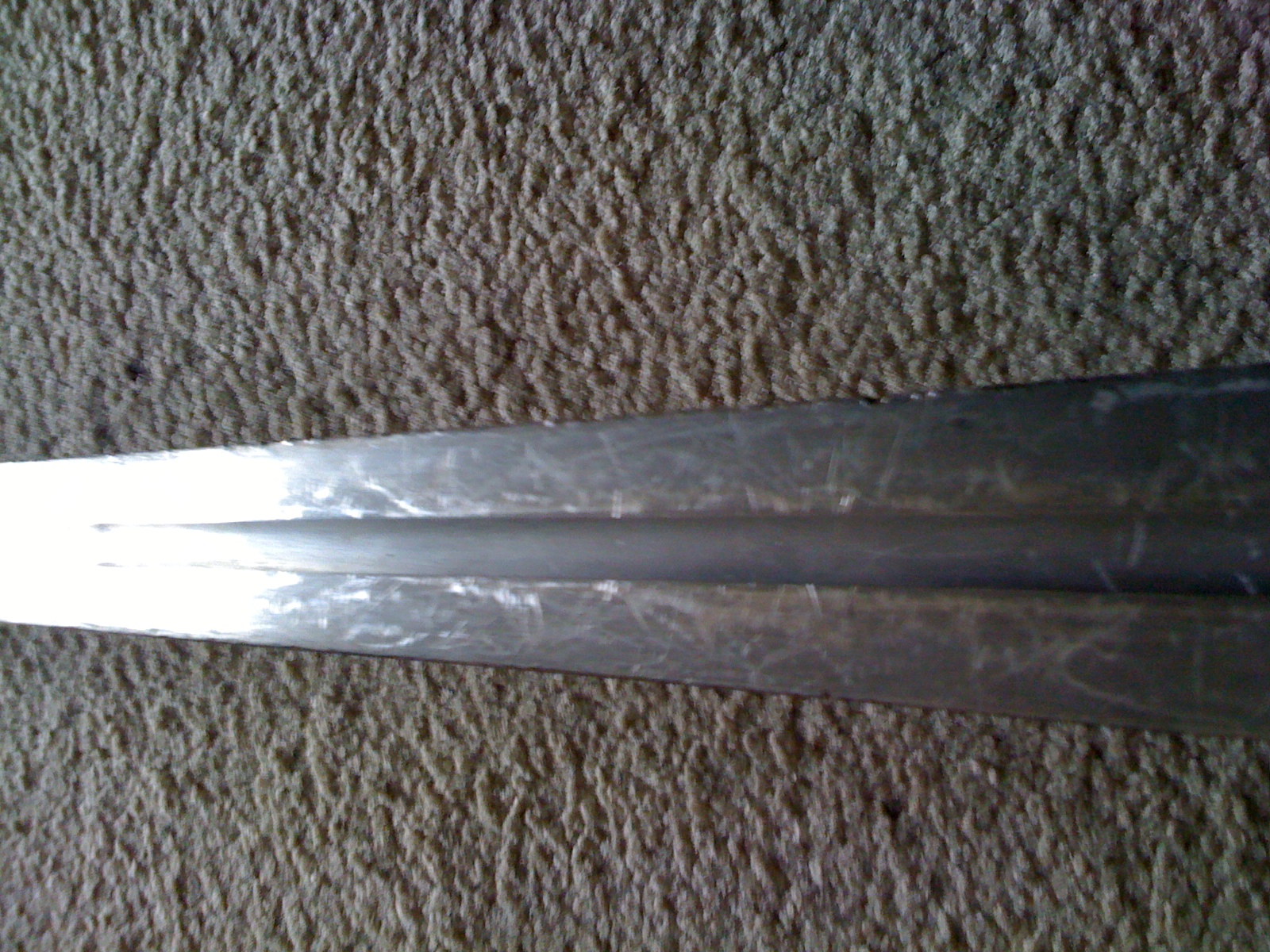

Here is a link to a few pictures I've just taken of my two longswords:
https://picasaweb.google.com/AndrewFUlr ... vo7uWM3QE#
It is a usual practice for me and my fellows to file/sand out any gouges from our practice swords, and since we defend with the flat of the blade, a good-sized gouge is a very rare occurence for us. Since we do simultaneously deflect and strike in the same motion, sometimes we do get small nicks in our blade-again, these are usually sanded so that they don't catch on our partner's skin and/or encourage rust.

Andrew: Wow, thanks for the images! I think those will be very useful. It's good to see all the marks that can happen by defending with the flat of the blade. Could I be cheeky and ask for a close up on two of the pictures? On the second picture in the album there are some well defined marks where the blade is reflecting the orange lights. Could I get a close up of those? Could I also get a close up and of this part of your lichtenauer?: http://www.abfoglia.com/sword_Scratches_004_moredetail.jpg

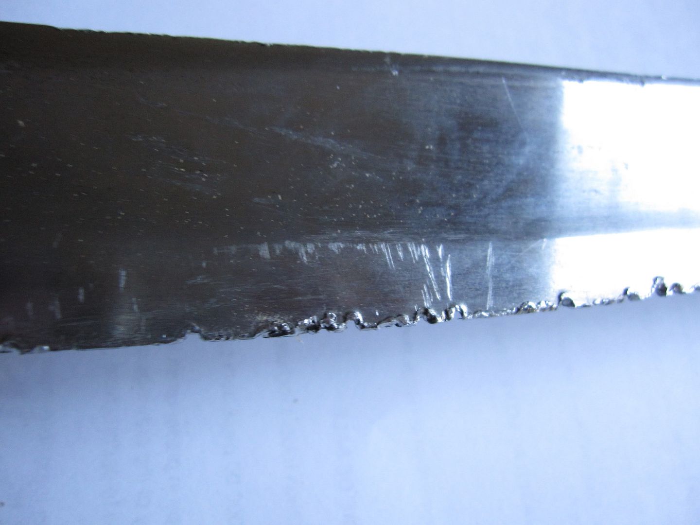

Here’s a close ups of my Sabre, This end is the cutting end, or near the tip of the blade. The nicks in the blade you should be well familiar with, they were created by someone parrying my attack with an edge on edge stop by putting their blade in the way of my incoming blade. The scrapes on the blade were made by ‘counter cuts,’ when I cut at someone and they cut at me at the same time, done correctly only one person gets hit. Mine is a curved blade so in doing so I generally take more advantage of the curve in the blade rather than the flat of the blade. For a strait blade I take end up having more drag on the flat than you see on this blade.

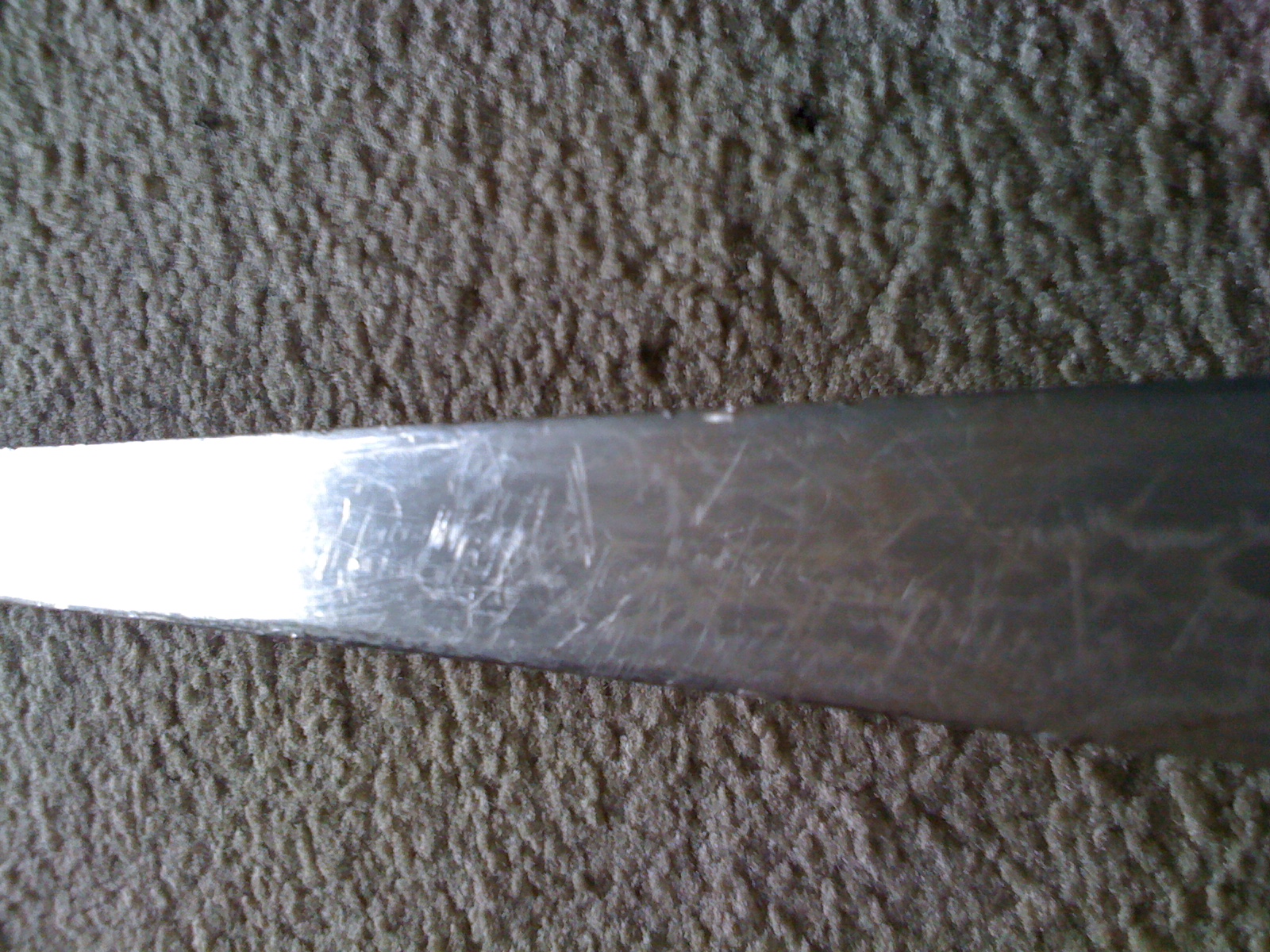

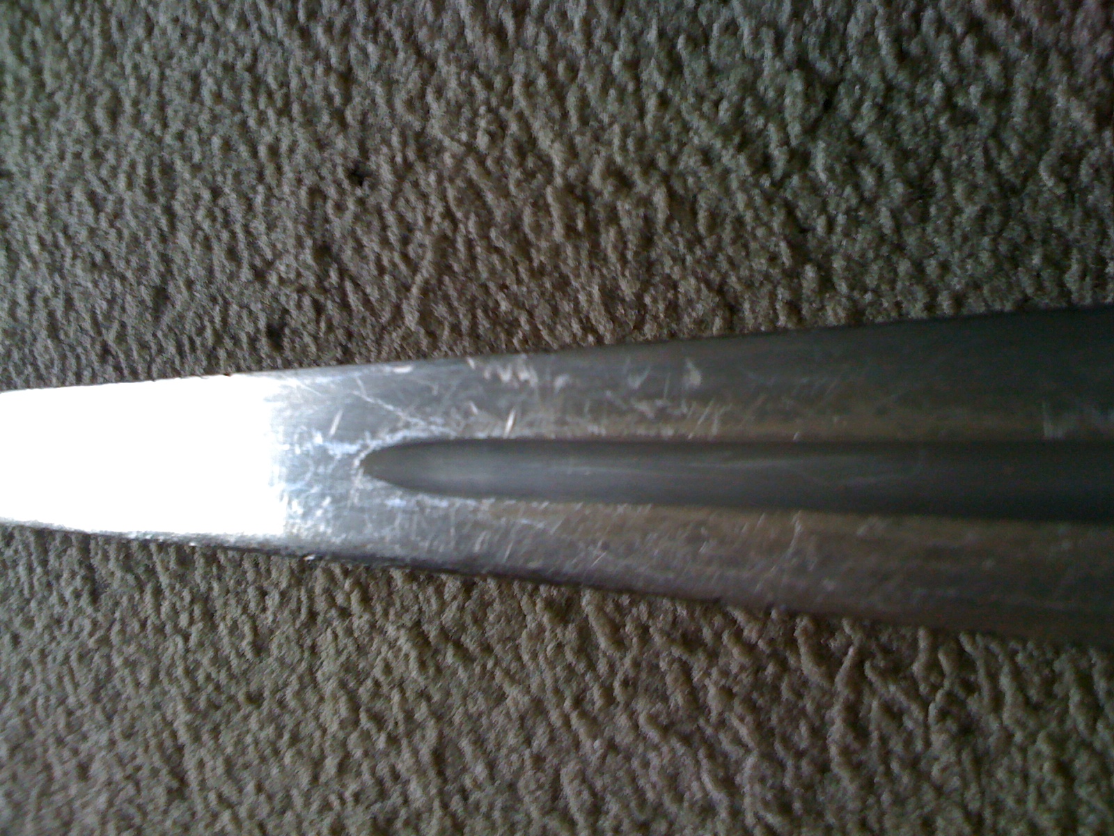

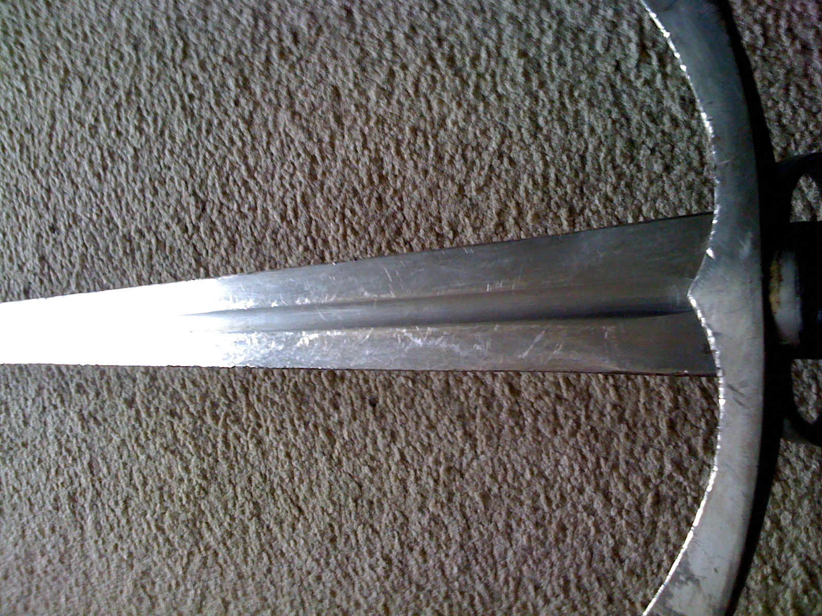

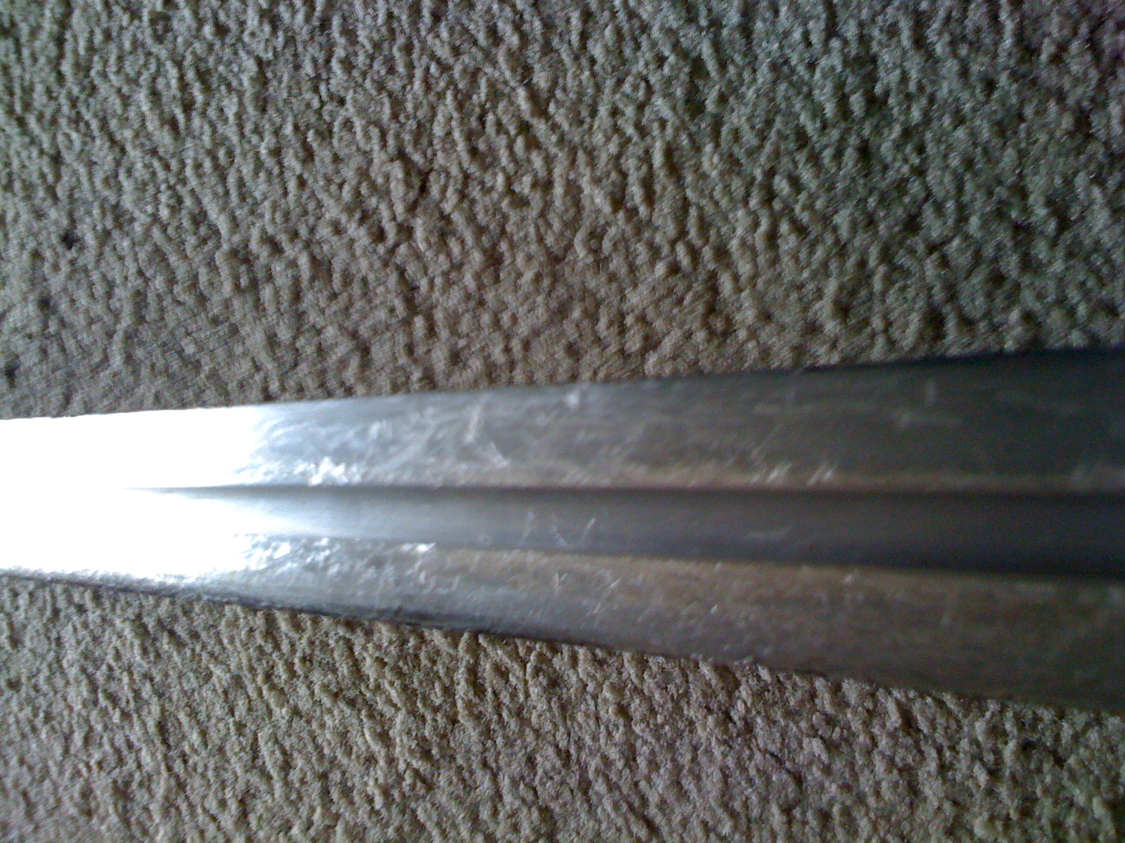

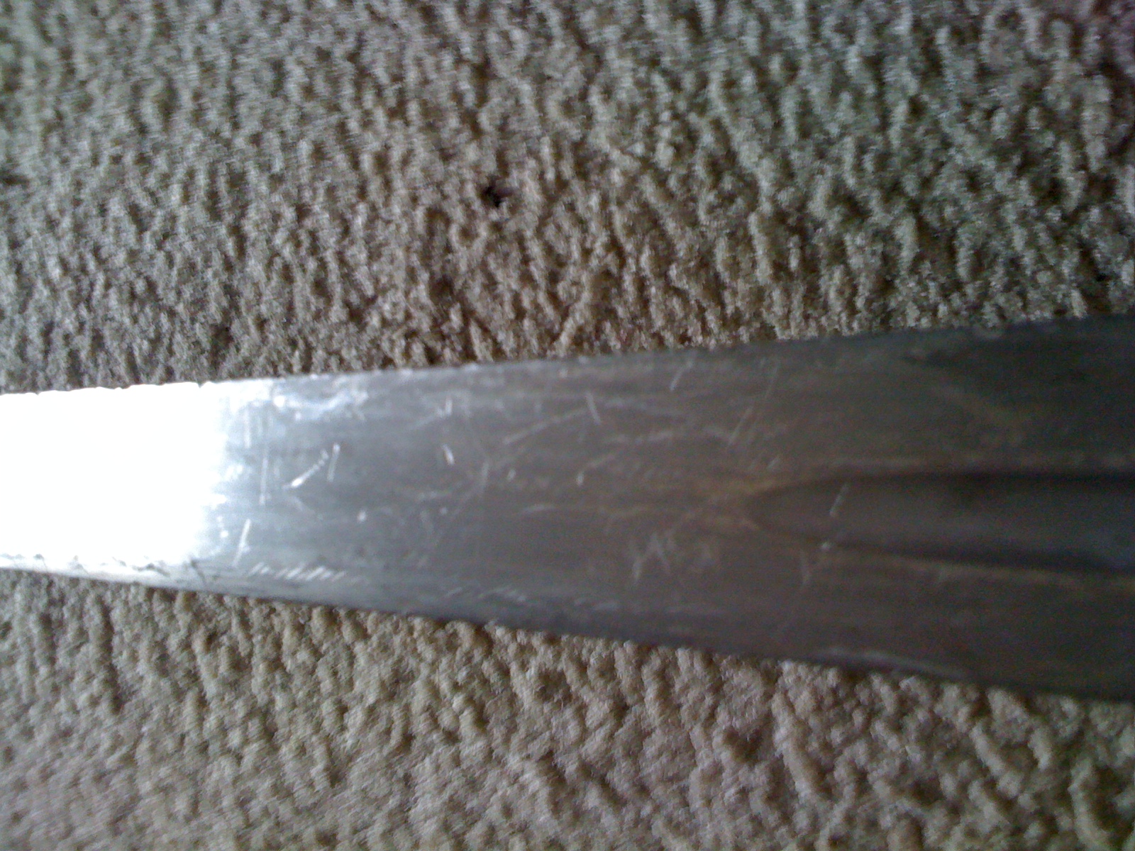

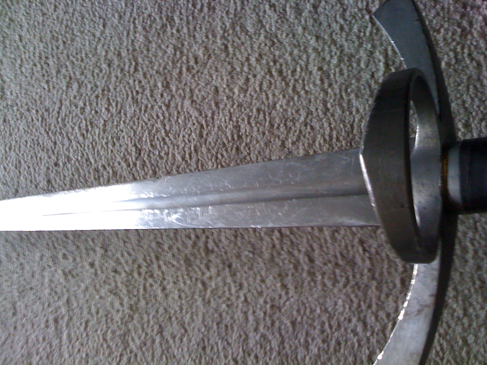

Postby Stacy Clifford » Wed May 11, 2011 10:51 am
OK, these are not the clearest pictures in the world, taken with a cell phone camera, but they should give you an idea what I'm talking about. You'll see a few nicks on the edges just because this blade is old and heavily used, and if you use anything long enough then stuff happens no matter how good your technique normally is. I took pictures of both sides of the blade. You have my permission to quote me and use the pictures I post on this thread if they are helpful.

Again, keep in mind that this is damage from parrying blunt steel blades, not sharp ones, and I would expect softer bronze to maybe show a little more trauma. You can see that almost all the damage is just shallow scrapes and scratches. The deeper scrapes in the image you asked about might be reasonably interpreted as combat damage, but it's hard to say for sure without knowing more about bronze. The best way to find out would be to get some bronze replica swords and try it out.
