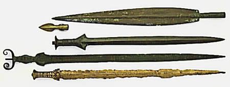

Ok, yeah I wondered about that. The one thing I had in mind was as you mentioned the leaf-shaped blades of the Celtic cultures during the Bronze and early Iron age. These swords were actually comparable in length to medieval swords as they were often used from horseback.
Since that style pretty much disappeared after that time period, I presume it was for good reason, namely that the extra mass at the tip of a sword that long wasn't necessary to provide an effective cut?
But I guess the same principle must apply to longer swords as with shorter ones, that the extra mass would lend much more percussive power to an already long sword.. so provided you had a well-made, well-balanced sword with a leaf-shaped blade, you'd have significantly more power to the cut than you would with a sword of typical medieval style. But, point taken, it's not necessary, especially since it would add a great deal of weight. Thanks for all your help, guys.

Could it also be that the extra width and mass in the leaf-shaped blades was structural compensation for the relatively weaker bronze to keep the blade from getting bent quite as easily? This wouldn't have been necessary in later iron and steel blades, and they could have been made narrower and more agile with the advent of tougher blade materials. I'm not discounting the extra cutting ability of the broader blade as an incentive to build it that way, but it could have served multiple purposes. I'm sure they just liked the way it looked too.

Yeah, good call. Honestly that hadn't occurred to me, though it ought to have as the metallurgy aspect of blades is something I'm also interested in. And yeah, the shape is very likely also a cultural reflection, though straight-edged swords were also prominent at that time.
However I would tend to think those were secondary to the fact that they just wanted strong slashing swords, since at that time armor was minimal.

Perhaps straight-edged blades had a thicker spine to compensate as opposed to leaf-shaped blades. That would be interesting to know if you could find or take measurements. There's more than one way to achieve greater structural integrity, and I'm sure enterprising smiths tried them all.
